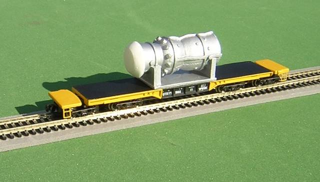

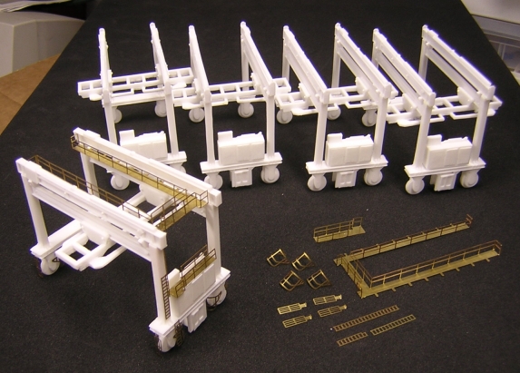

Gathered below are several links to a photo gallery I have on Trainboard. I started dabbling in mold making, resin casting and home etching in late 2004. A guy named Harold Grady put a notion in my head that the one PS2 3bay rib side covered hopper I made needed to be mass produced so that one thing is what got me started. Needless to say the project never got as big as it should have. Knowing what I know now, would have been a breeze. Robert Ray is the owner of all the PS2 castings that are shown in one of the photos.
Note, most of these photos combine castings and home etched brass to complete the projects!

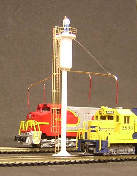

www.trainboard.com/railimages/data/506/ST1.jpg
Sanding Tower

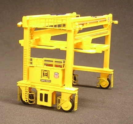

www.trainboard.com/railimages/data/506/14.jpg
Mi-Jack Translift Crane
www.trainboard.com/railimages/data/500/DSCN3243a.jpg
Several Mi-Jacks
www.trainboard.com/railimages/data/506/6a1.JPG
Molds to cast the pieces for the Mi-Jack

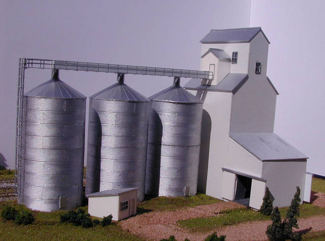

www.trainboard.com/railimages/data/506/Rural_Grain_Elevator_002_edited.jpg
One of the two grain elevators I use to cast, 2005

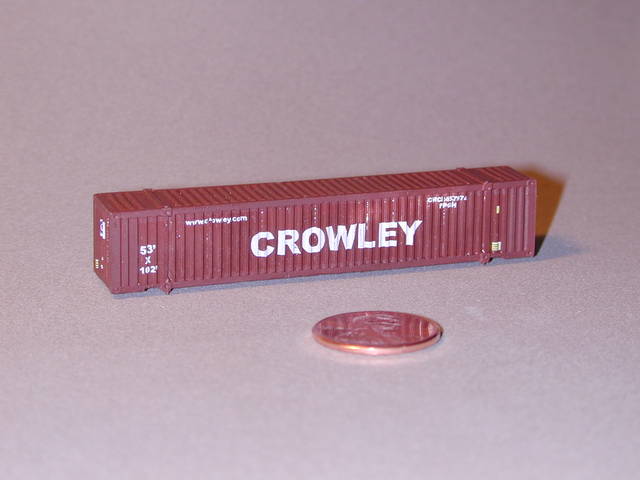

www.trainboard.com/railimages/data/506/DSCN14211.JPG
53' Smooth side containers, 2005

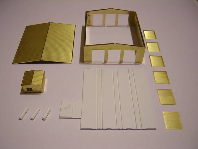

Intermodal Entrance building, shed and guard shacks, 2006

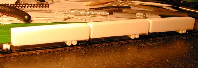

www.trainboard.com/railimages/data/506/DSCN2181a.jpg
48' Trailers to ride on my Spine cars

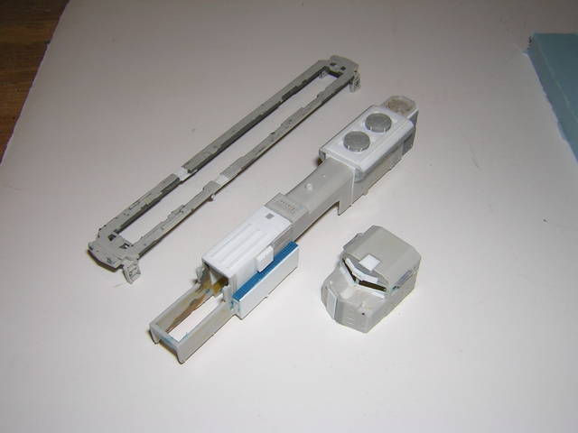

www.trainboard.com/railimages/data/506/DSCN5743.JPG

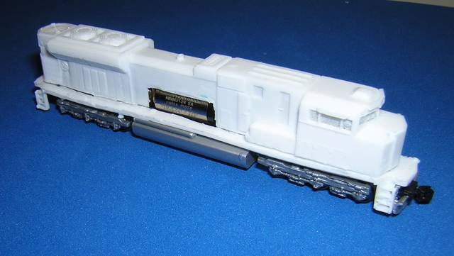

SD70ACe shell, cab and walkway

Turbine Load for the 195ton HD Flat car
Those are alot of examples of things I have cast in the past. I have two projects where I took many photos while making the molds too.

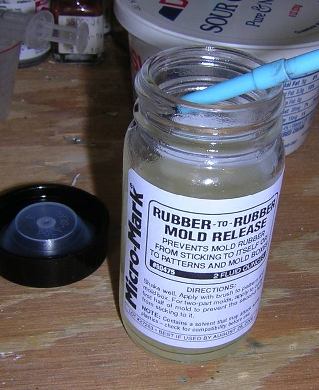

You mentioned one word that does not sit well with me and that is "quick". Without asking I presume you are talking about the CR300 resin. Suppose to have 3-4 minutes work time, 10 minutes set up and within 30 minutes demold the casting.
I tried it once!!!ONCE!!!! I hate the stuff!!! When I ready molds for casting, I have several and to mix one batch of the CR300 I would only have time to fill one, maybe two molds(even small molds) before the resin starts to gel. Nope, need a watery consistancy for at least 8-10 minutes as I fill usually 4-7 molds and need the time to ensure no bubble activity too. I use the CR600. I wait on average of 54 minutes to de-mold. Sometimes the casting is still plyable, sometimes not, but all in all the casting will eventually harden completely. 54 minutes is a norm for my casting, be it with or without the pressure pot.
Looking at the above mentioned website I see that WD40 makes several mold releases. I will definitely try the top one listed as it sounds like just what will work to prolong the Micro-Mark RTV rubber so I can get perhaps double or more castings from it. Average for me, depending on mass of detail, 10 to 30 castings per mold, if I am lucky and designed the mold right.

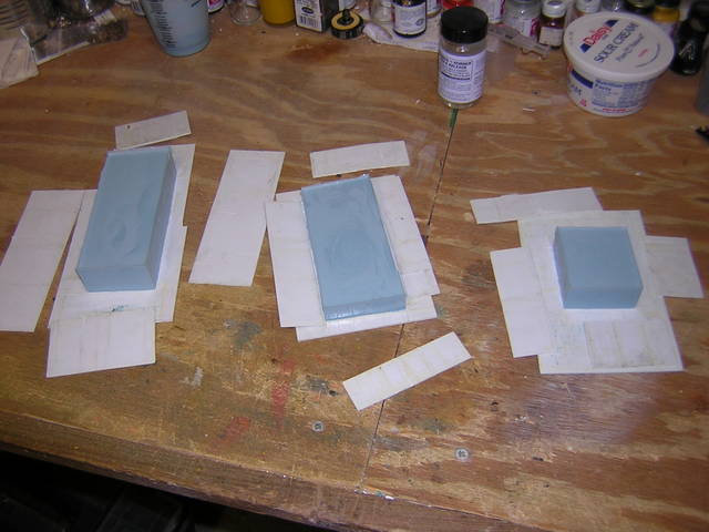

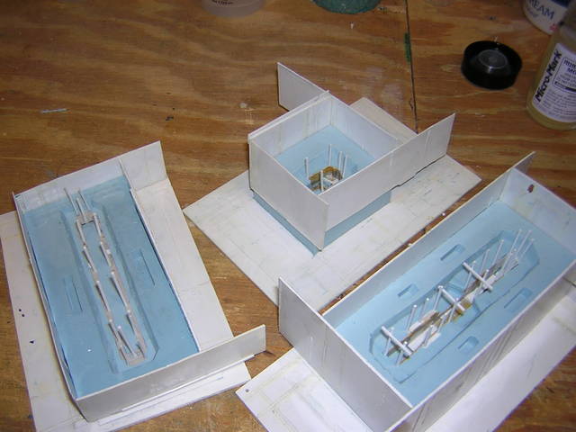

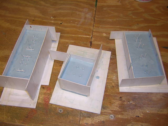

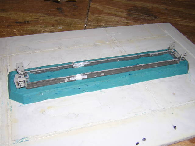

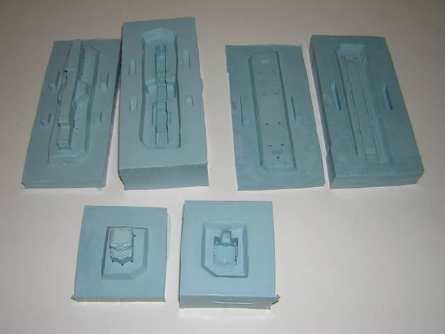

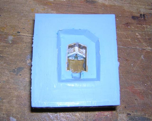

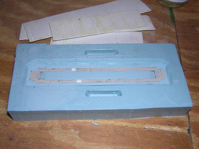

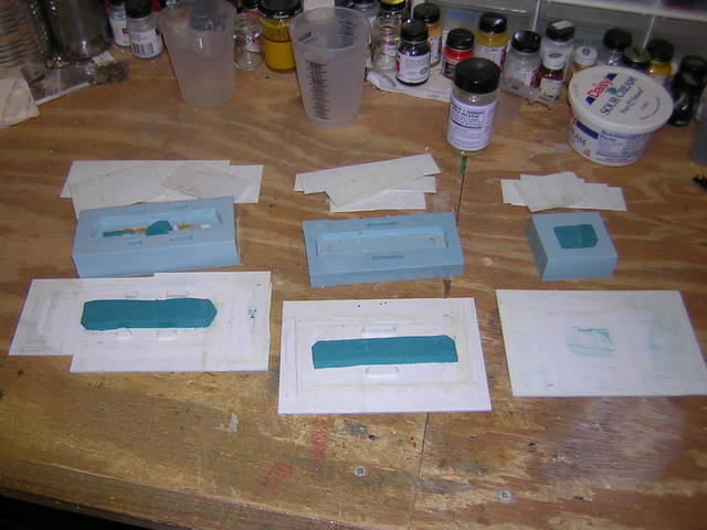

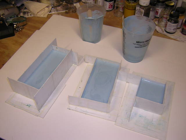

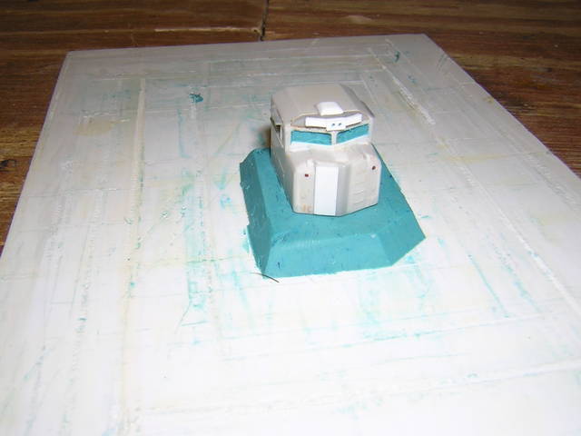

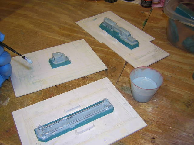

Here are some photos of my making the molds for the SD70ACe shell, cab, and walkway(which needs revising).
Prep the mold and build a reverse mold;
www.trainboard.com/railimages/data/500/DSCN5677.JPG
www.trainboard.com/railimages/data/500/DSCN5682.JPG
www.trainboard.com/railimages/data/500/DSCN5686.JPG
I will brush on thin coats of RTV to ensure no bubbles are touching the masters.
www.trainboard.com/railimages/data/500/DSCN5689.JPG
I then build the mold sides using styrene .040" sheet plastic, mix RTV and pour carefully into the molds. I vibrate the molds by tapping fingers under the the molds after pouring or slowly tilt the molds in all points on the compass to make bubbles rise to the top.
www.trainboard.com/railimages/data/500/DSCN5690.JPG
Remove the styrene sides
www.trainboard.com/railimages/data/500/DSCN5707.JPG
Carefully remove the RTV from the molds once it's cured 3-4 hours. Carefully remove any clay used to create the contour.
www.trainboard.com/railimages/data/500/DSCN5708.JPG
Once the clay is removed, remove any areas of RTV where it might have seeped into cracks or tiny nooks-n-crannies. Areas where it does not need to be.
www.trainboard.com/railimages/data/500/DSCN5709.JPG
www.trainboard.com/railimages/data/500/DSCN5710.JPG
www.trainboard.com/railimages/data/500/DSCN5712.JPG

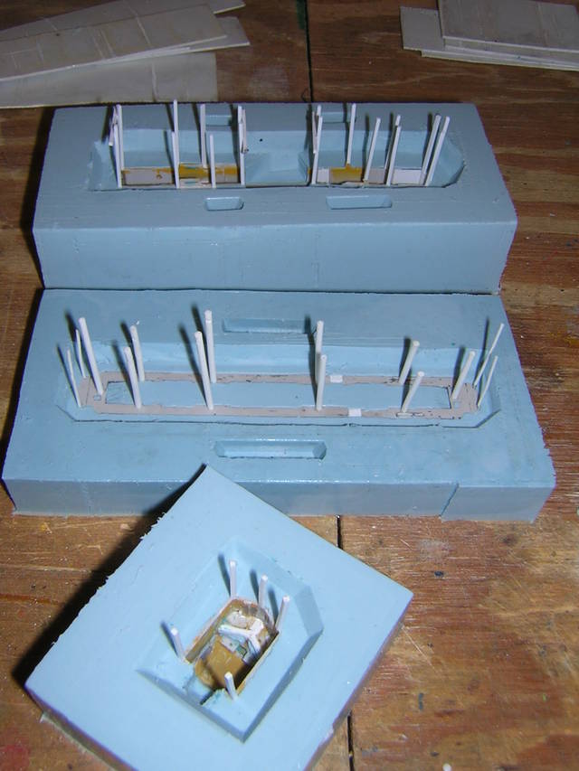

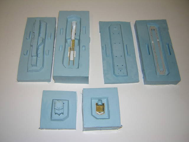

Next, secure styrene round or square rod to raised areas or the master or areas where you might get bubbles.
www.trainboard.com/railimages/data/500/DSCN5713.JPG
Then take the styrene sides you used to build up the first mold and attach them around the molds as shown. This time the sides ARE NOT glued to the bottom styrene sheet. Raise them so you can pour the RTV as high as you need to cover the master.
www.trainboard.com/railimages/data/500/DSCN5714.JPG

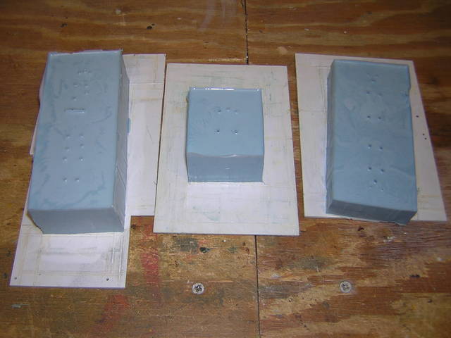

Next, Very Important to coat the exposed RTV with a rubber-to-rubber release agent so that the top we are about to pour DOES NOT stick to the bottom mold already poured. IF YOU FORGET THIS PART, you will be cutting your master out of the mold with a hobby knife.
www.trainboard.com/railimages/data/500/DSCN5715.JPG
Next mix up more RTV and pour. Use the brush on thin layers first if you have exposed detail on this side too that needs to remain bubble free.
www.trainboard.com/railimages/data/500/DSCN5716.JPG

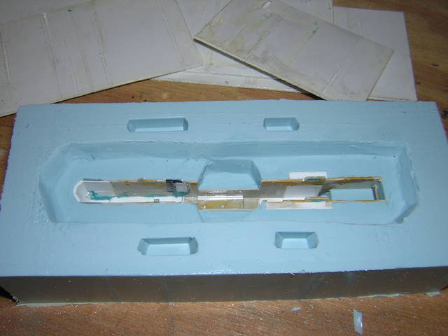

Once the RTV has set and dried, remove styrene sides and carefully seperate the top from the bottom mold.
www.trainboard.com/railimages/data/500/DSCN5717.JPG
This is the end result before I remove the masters.
www.trainboard.com/railimages/data/500/DSCN5719.JPG
Here are the 3 masters for this project, crafted by the one and only David Freehling!!!
www.trainboard.com/railimages/data/500/DSCN5720.JPG
And this is what the molds look like with the masters removed.
www.trainboard.com/railimages/data/500/DSCN5721.JPG
Please note, there are many different ways to make molds for casting in resins or metals. Both are different and similar in design and creation but it depends on the persons preferences. I make the majority of my molds like described above. I find I can get more bubble free castings by using the "Squish" mold method as opposed to the pour in the canal slowly and hope the detail is bubble free. Nope, not for me. Micro-Mark send a mold making instruction sheet with every set of RTV and resin and this way of doing it is not my prefered way. Nope! You have to do what works best for you. What I do, have done, and will do in the future depends on what I am wanting to cast in multiples. For this fact, when you hear me say Experience has taught me what I know about casting and mold making believe you me I have wasted many many many bottles of resin and RTV in gaining what I know today!!
Now, ask away!!!!! I know you have questions!!!!
Hobo Tim :)

Now, mold design is another issue I have come across. If I make a mold that will no doubt be cast using my pressure pot I will add resin resevoirs inside the mold so when pressure is applied and the resin is compressed, there is extra resin to fill the void that the bubble created when shrunk. Sometimes the vent holes in the top mold don't hold enough extra resin so I add the extra. An example will be the molds I made for the Mi-Jack crane. I made about 5 set of this mold in order to cast more than 50 Mi-Jack's, some molds being made twice as many times being I needed two of that part for one Mi-Jack.
Here is a photo of the molds and then a photo showing the highlighted lime green areas for extra resin!
www.trainboard.com/railimages/data/506/65.jpg
Here is a detail of how I made these molds;
Prepping the masters for the Squish Mold method
www.trainboard.com/railimages/data/506/216.jpg
www.trainboard.com/railimages/data/506/119.jpg
Build up the styrene sides
www.trainboard.com/railimages/data/506/316.jpg
Brush on top thin layers to eliminate bubbles in RTV touching the masters, then pour RTV to fill the area!
www.trainboard.com/railimages/data/506/413.jpg
And the rest of the mold making is as described in the above message for the second pour. The only difference is the fact that some of the clay is left in the second pour. It will become the area for extra resin.
Hope this helps anyone wanting to eliminate the problem with a few unwanted bubbles in their castings. Remember, this works on small bubbles, not the big ones!!! Small bubbles are tiny bubbles!!
