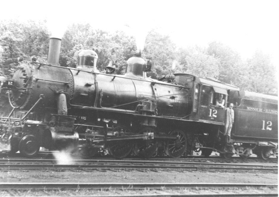

Advanced bashers could certainly use the chassis for a Consolidation (2-8-0) or a USRA 0-8-0. The Consolidation was one of the most popular wheel configurations for steamers, and appeared throughout most of the steam era; one can find no end of variations that could be suitable. Here's just a couple--
www.pasty.com/copperrange/iroquois.jpg
www.trainweb.org/screamingeagle/other/beckermann/M-I/M&I_12-b.jpg

Other possibilities... a 2-8-0. Baldwin built a raft of Consolidations with 52-inch drivers. These look like they may have possibilities:
media-cdn.tripadvisor.com/media/photo-s/01/15/b2/e8/1924-baldwin-2-8-0-steam.jpg
www.taplines.net/0307/chn03_files/chn74.jpg
