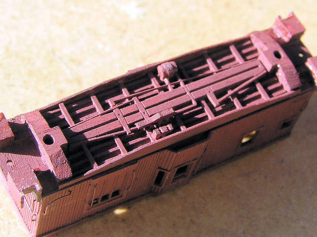

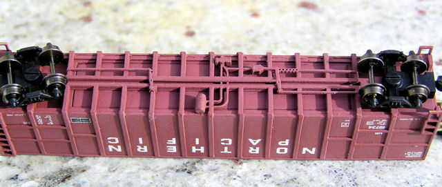

I pretty much always use a couple layers of 1/36" thick material stacked up to make my bolsters. I laser cut .055" circles in the bolster, then use a 1/16" drill bit to clean out the hole before pushing the bolster pin in.
Just look at the bolster pieces of this car, to see the general shape used:
Here you can see a car with AZL trucks installed, and the wheels have clearance on each side of the bolster:
